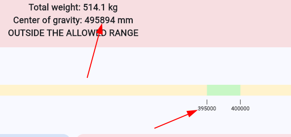

Ludovic Launer Posted May 7 Report Posted May 7 (edited) 13 hours ago, Carls said: @Ludovic: It commencé à intégrer vos suggestions d'amélioration. Les bonnes choses prentent du temps. You can also use it to have the leftovers. @Carls OK merci Petit probleme avec le passage aux mm Edited May 7 by Ludovic Launer Quote Ludovic Launerwww.launer.fr
carls Posted May 7 Author Report Posted May 7 (edited) Can you send me the Profile or post it here please. If you open the profile again it Must be ok Edited May 7 by carls Quote
Ludovic Launer Posted May 7 Report Posted May 7 (edited) { "name": "Ventus 3M (Community)", "d6": "418", "d7": "", "d16": "610", "d17": "82", "d18": "", "fuelMain": "13", "fuelWing": "1", "waterBallast": "", "hBat": "4194", "hPilot": "-580", "hCopilot": "0", "hMain": "425", "hWing": "194", "hWaterBallast": "194", "oxygen": "0", "hOxygen": "0", "trim": "4", "hTrim": "-1800", "pilotStart": "0", "pilotMm": "0", "copilotStart": "0", "copilotMm": "0", "spMin": "320", "spMax": "430", "spOptMin": "395", "spOptMax": "400", "extra1Name": "Baggage", "extra1Weight": "2", "extra1Arm": "285", "extra2Name": "", "extra2Weight": "0", "extra2Arm": "0", "extra3Name": "", "extra3Weight": "0", "extra3Arm": "0" } Edited May 7 by Ludovic Launer Quote Ludovic Launerwww.launer.fr
carls Posted May 7 Author Report Posted May 7 (edited) This evening i‘ll look did you changed the Parameters in the file by yourselF? Normaly the files are still in Meters, only the App changes it to Millimeter Edited May 7 by carls Quote
Ludovic Launer Posted May 7 Report Posted May 7 (edited) I originally entered the value in mm in the app, this explains why they're in mm in the profile. I should then change them to m in the profile so that they appear as mm in the app. Thanks Edit: I've created a new profile, entered the data in mm, saved the profile. When I export the data it's in mm inside the .json and the calculations are still showing values 1000x too big Edited May 7 by Ludovic Launer Quote Ludovic Launerwww.launer.fr
carls Posted May 7 Author Report Posted May 7 (edited) Thanks, but the Ventus Community Profil is Not in Millimeter. I‘ll Check it this evening, perhaps we have a bug. we have a bug Edited May 7 by carls Quote

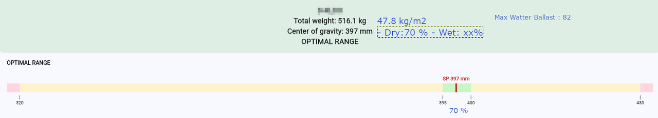

Ludovic Launer Posted May 8 Report Posted May 8 (edited) Thanks. In blue on the screenshot the additional information that I think is needed: @carls would you be considering open sourcing it on github so that I can contribute ? Edited May 8 by Ludovic Launer Quote Ludovic Launerwww.launer.fr
